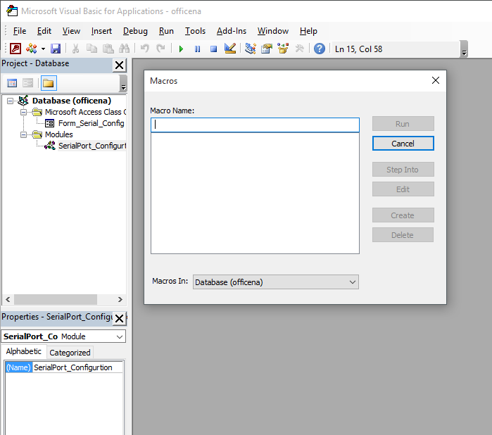

 Thanks for having such a kind person like you
However I would'nt seem to make it work
Can you please teach me how I can make it workimage.png.ba3473ed0e6050974a8433bb1c0d636e.png

Because your computer does not support Arabic, I will design the program for you but give me a little time
