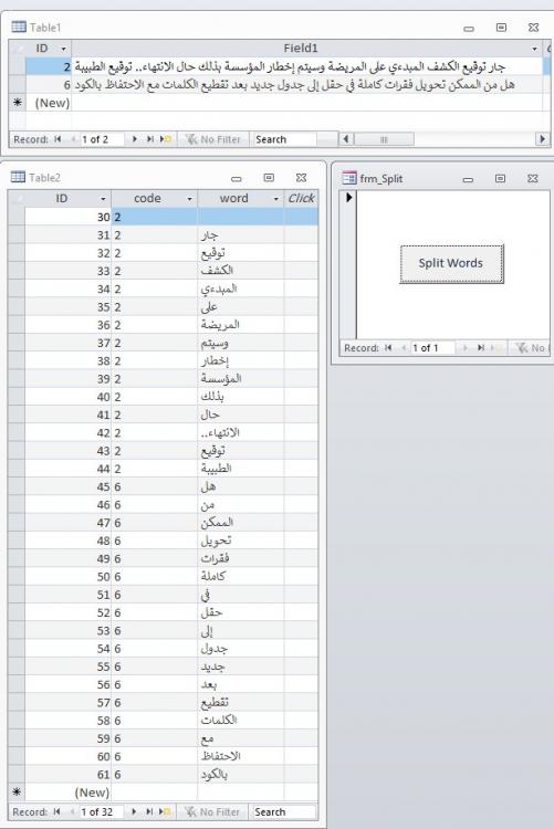

jjafferr قام بنشر نوفمبر 30, 2016 مشاركة قام بنشر نوفمبر 30, 2016 تفضلي هذا الكود Private Sub cmd_Split_Click() Dim x() As String Dim rstFrom As DAO.Recordset Dim rstTo As DAO.Recordset 'busy hour glass ON DoCmd.Hourglass True 'set both tables for In/Out data Set rstFrom = CurrentDb.OpenRecordset("Select * From Table1") Set rstTo = CurrentDb.OpenRecordset("Select * From Table2") 'clear Table2 CurrentDb.Execute ("Delete * From Table2") 'move the cursor to the first Record rstFrom.MoveLast: rstFrom.MoveFirst rcFrom = rstFrom.RecordCount 'count the records 'read all the records, one at a time For iFrom = 1 To rcFrom 'split the required field, based on empty spaces x = Split(rstFrom!Field1, " ") 'iterate through these splited words For i = LBound(x) To UBound(x) 'add them to the second table, and update the record rstTo.AddNew rstTo!code = rstFrom!ID rstTo!word = x(i) rstTo.Update Next i 'move to the next record rstFrom.MoveNext Next iFrom 'busy hour glass OFF DoCmd.Hourglass False 'clearing the memory rstFrom.Close: Set rstFrom = Nothing rstTo.Close: Set rstTo = Nothing End Sub . والنتيجة . جعفر 463.index.mdb.zip 3 رابط هذا التعليق شارك More sharing options...
ابو جودي قام بنشر نوفمبر 30, 2016 مشاركة قام بنشر نوفمبر 30, 2016 (معدل) الان, jjafferr said: تفضلي هذا الكود Private Sub cmd_Split_Click() Dim x() As String Dim rstFrom As DAO.Recordset Dim rstTo As DAO.Recordset 'busy hour glass ON DoCmd.Hourglass True 'set both tables for In/Out data Set rstFrom = CurrentDb.OpenRecordset("Select * From Table1") Set rstTo = CurrentDb.OpenRecordset("Select * From Table2") 'clear Table2 CurrentDb.Execute ("Delete * From Table2") 'move the cursor to the first Record rstFrom.MoveLast: rstFrom.MoveFirst rcFrom = rstFrom.RecordCount 'count the records 'read all the records, one at a time For iFrom = 1 To rcFrom 'split the required field, based on empty spaces x = Split(rstFrom!Field1, " ") 'iterate through these splited words For i = LBound(x) To UBound(x) 'add them to the second table, and update the record rstTo.AddNew rstTo!code = rstFrom!ID rstTo!word = x(i) rstTo.Update Next i 'move to the next record rstFrom.MoveNext Next iFrom 'busy hour glass OFF DoCmd.Hourglass False 'clearing the memory rstFrom.Close: Set rstFrom = Nothing rstTo.Close: Set rstTo = Nothing End Sub . والنتيجة . جعفر 463.index.mdb.zip الاستاذ الفنان جعفر تم تعديل نوفمبر 30, 2016 بواسطه ابا جودى رابط هذا التعليق شارك More sharing options...
wael_rafat قام بنشر نوفمبر 30, 2016 مشاركة قام بنشر نوفمبر 30, 2016 (معدل) اضافة الي كلام اخي ابا جودي هو استاذ - فنان - عبقري - خبرة - سااااااحر ........... الخ ماشاء الله ربنا يبارك فيه و يجازيه عنا كل خير.. تم تعديل نوفمبر 30, 2016 بواسطه wael_rafat 1 رابط هذا التعليق شارك More sharing options...
jjafferr قام بنشر نوفمبر 30, 2016 مشاركة قام بنشر نوفمبر 30, 2016 رابط هذا التعليق شارك More sharing options...

jjafferr قام بنشر ديسمبر 1, 2016 مشاركة قام بنشر ديسمبر 1, 2016 وعليكم السلام عفوا اختي ، ولكن اريد منك تفصيل اكثر لوسمحتي ، مثلا: 1. نحن لا نتكلن عن تحديث سجلات ، وانما عمل سجلات جديدة ، صح؟ 2. هل تريدين سجلات جديدة للجدول بالكامل؟ أ- هذا معناه حذف السجلات السابقة ، والعمل على سجلات جديدة مرة اخرى ، ب- هذا معناه ان البرنامج سيأخذ وقت اطول كلما زادت عدد السجلات. 3. واذا كانت هناك سجلات تم العمل عليها سابقا ، فهل تريدين العمل عليها مرة اخرى: أ- في بعض الاوقات الكود يعطينا نتائج غير متوقعة ، مثل السجل الاول الفاضي في الصورة التي ارفقتها ، وهي بسبب ان الجملة اصلا فيها مسافة فاضية ، ب- فعند التدقيق ، قد تحذفين هذا السجل يدويا ، ولكن قد لا تصلحين مكان الخطأ في الجملة ، ج- فهل تريدين الابقاء عليها؟ ورجاء اعطاء اي بيانات اخرى عن المشروع ، حتى لا نقوم بالعمل مرار جعفر رابط هذا التعليق شارك More sharing options...
girl قام بنشر ديسمبر 1, 2016 الكاتب مشاركة قام بنشر ديسمبر 1, 2016 1 دقيقه مضت, jjafferr said: وعليكم السلام عفوا اختي ، ولكن اريد منك تفصيل اكثر لوسمحتي ، مثلا: 1. نحن لا نتكلن عن تحديث سجلات ، وانما عمل سجلات جديدة ، صح؟ صح ... والجدول رقم 2 هو غير موجود بالاصل كان مضاف في المثال لإيضاح النتيجة المطلوبة ، محتاجة مكانه استعلام تحديد، وده هيحل مشاكل النقاط الأخرى... فهل هو ممكن ؟. 2. هل تريدين سجلات جديدة للجدول بالكامل؟ أ- هذا معناه حذف السجلات السابقة ، والعمل على سجلات جديدة مرة اخرى ، ب- هذا معناه ان البرنامج سيأخذ وقت اطول كلما زادت عدد السجلات. 3. واذا كانت هناك سجلات تم العمل عليها سابقا ، فهل تريدين العمل عليها مرة اخرى: أ- في بعض الاوقات الكود يعطينا نتائج غير متوقعة ، مثل السجل الاول الفاضي في الصورة التي ارفقتها ، وهي بسبب ان الجملة اصلا فيها مسافة فاضية ، ب- فعند التدقيق ، قد تحذفين هذا السجل يدويا ، ولكن قد لا تصلحين مكان الخطأ في الجملة ، ج- فهل تريدين الابقاء عليها؟ ورجاء اعطاء اي بيانات اخرى عن المشروع ، حتى لا نقوم بالعمل مرار جعفر رابط هذا التعليق شارك More sharing options...

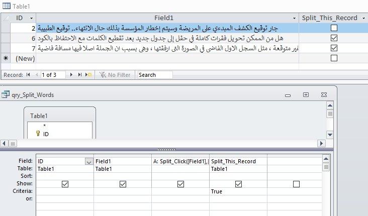

jjafferr قام بنشر ديسمبر 1, 2016 مشاركة قام بنشر ديسمبر 1, 2016 تفضلي حولت الكود الى وحدة نمطية ، وستلاحظين اني الغيت اسطر من الكود ، لان الجملة ستاتي من الاستعلام (والاستعلام ليس استعلام سجلات جديدة ، انما هو استعلام تحديد ، حيث يحدد السجلات المطلوب تفكيك كلماتها ويرسلها للوحدة النمطية ، والتي تقوم بالتفكيك): Function Split_Click(Letters, Record_ID) Dim x() As String ' Dim rstFrom As DAO.Recordset Dim rstTo As DAO.Recordset 'busy hour glass ON ' DoCmd.Hourglass True 'set both tables for In/Out data ' Set rstFrom = CurrentDb.OpenRecordset("Select * From Table1") Set rstTo = CurrentDb.OpenRecordset("Select * From Table2") 'clear the Record number sent from Table2, so that we start again CurrentDb.Execute ("Delete * From Table2 Where [code]='" & Record_ID & "'") 'move the cursor to the first Record ' rstFrom.MoveLast: rstFrom.MoveFirst ' rcFrom = rstFrom.RecordCount 'count the records 'read all the records, one at a time ' For iFrom = 1 To rcFrom 'split the required field, based on empty spaces x = Split(Letters, " ") 'iterate through these splited words For i = LBound(x) To UBound(x) 'add them to the second table, and update the record rstTo.AddNew rstTo!code = Record_ID rstTo!word = x(i) rstTo.Update Next i 'move to the next record ' rstFrom.MoveNext ' Next iFrom 'busy hour glass OFF ' DoCmd.Hourglass False 'clearing the memory ' rstFrom.Close: Set rstFrom = Nothing rstTo.Close: Set rstTo = Nothing End Function . تم اضافة حقل جديد في الجدول Table1 ، حتى تختارين السجلات التي تريدين تفكيك كلماتها ، واستخدام هذا الحقل كشرط في الاستعلام: . جعفر 463.1.index.mdb.zip وهذا الرابط به شرح من اخونا العود ابوخليل جعفر رابط هذا التعليق شارك More sharing options...
girl قام بنشر ديسمبر 1, 2016 الكاتب مشاركة قام بنشر ديسمبر 1, 2016 شكرا لجهدك الاستعلام يخرج الجدول1 كما هو دون تقطيع ماذا أفعل؟ رابط هذا التعليق شارك More sharing options...
jjafferr قام بنشر ديسمبر 1, 2016 مشاركة قام بنشر ديسمبر 1, 2016 النتيجة في الجدول 2 رابط هذا التعليق شارك More sharing options...
